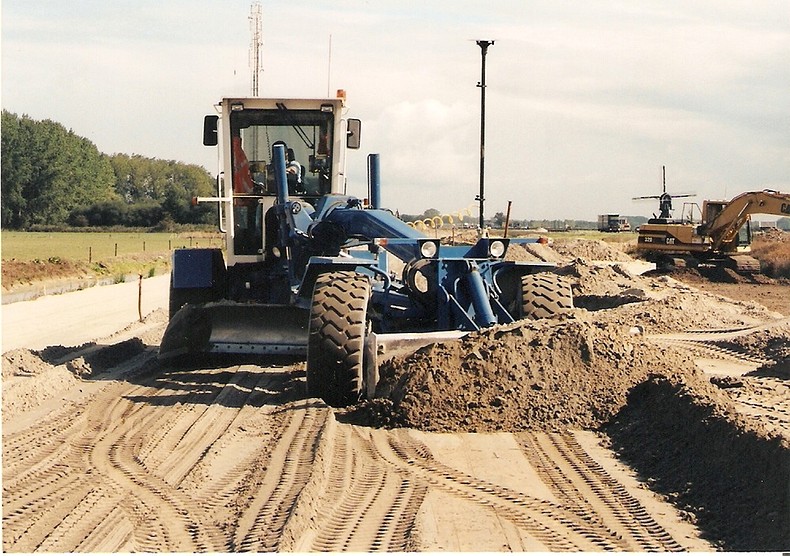

I post a photo from a O&K 156A grader where i widened the front blade from 2,50 m to 3 m so the wheels stay between the windrows and the machine is more stabile when using the front blade .
Roel .

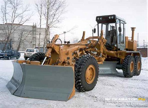

I have two photo,s of a Cheliabinsk grader with a strange frontblade .
Roel .
