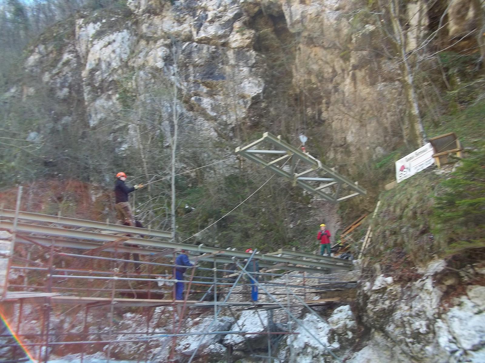

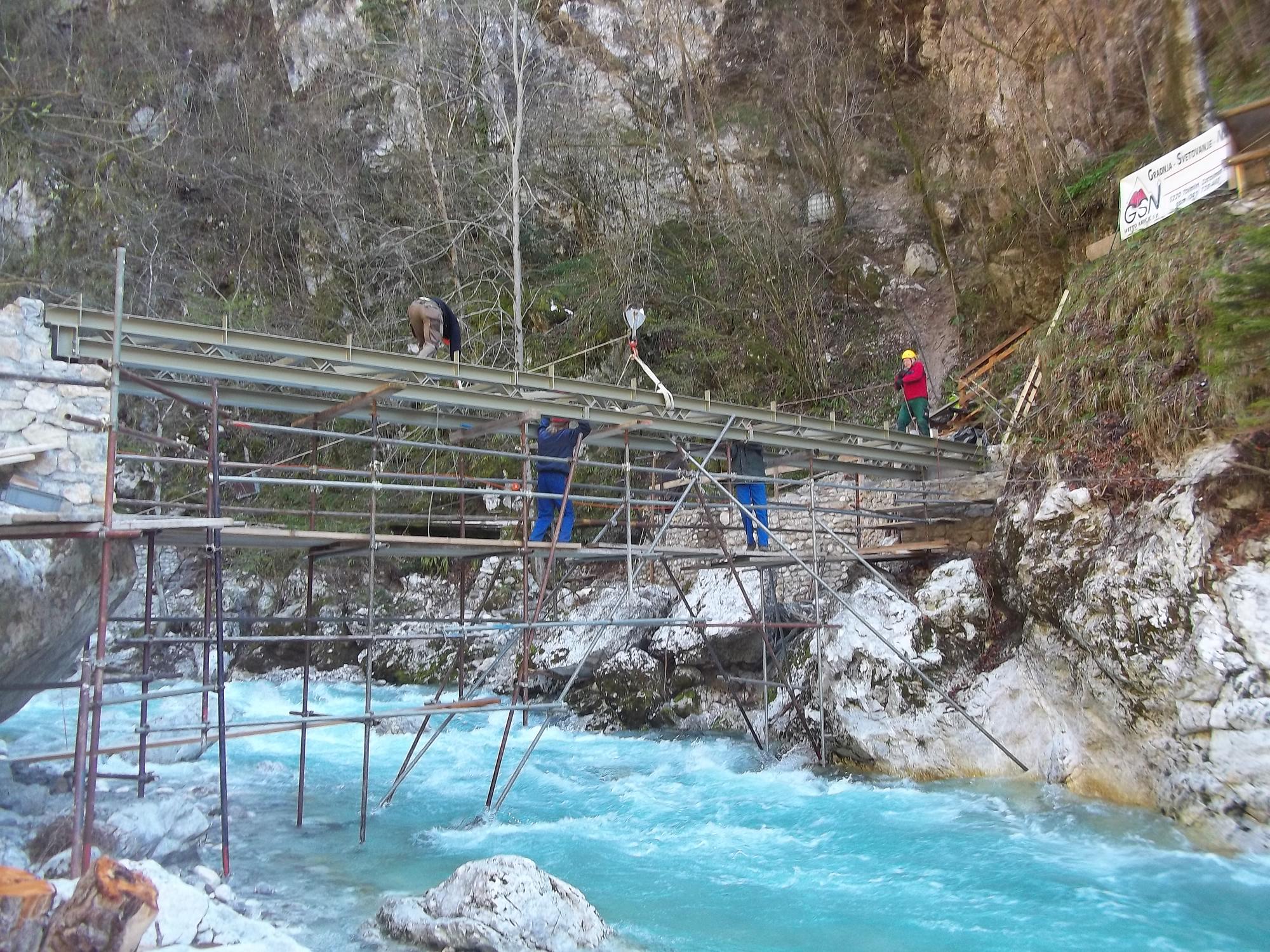

The cable lift was located quite out of bridge line so each section had to be placed by ropes and pulleys.

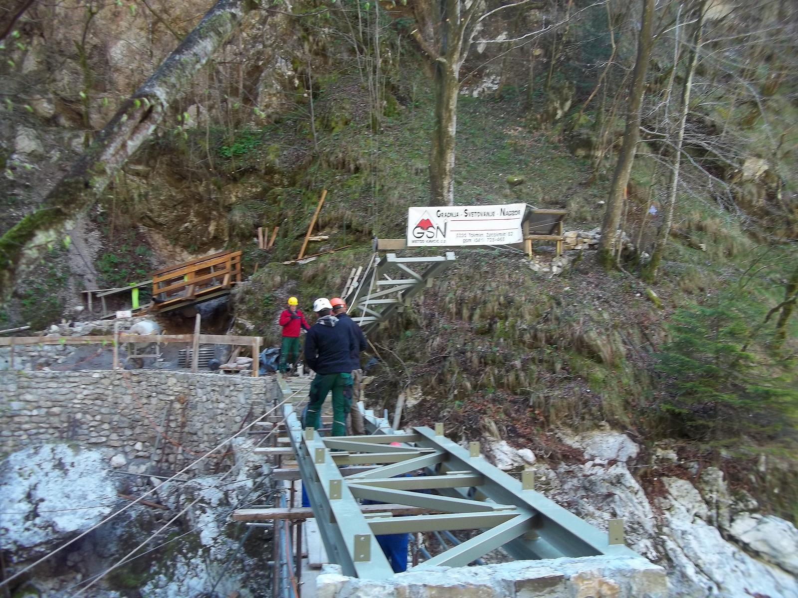

The bridge is located at the narrowest point of the canyon so the water level changed almost from hour to hour due to heavy raining a few kilometers up the stream.

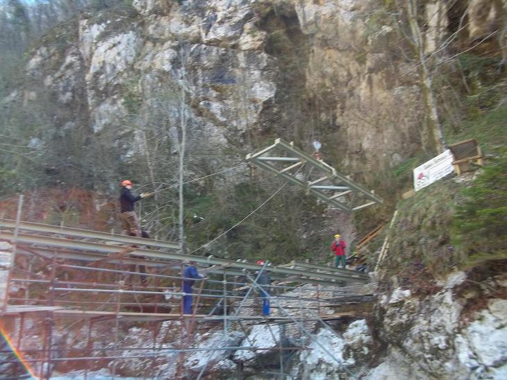

The main contractor GSN who also had to built almost 50m of supporting walls delivered cca. 100 tons of gravel and stones to the site, all by cable lift with a 100 liters bucket...
