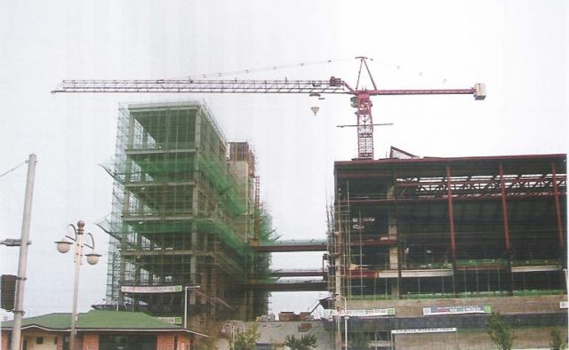

kroll k-550 from 1996 Max load is 40 tonnes . Max hook height-92 m , rail/going, freestanding

Perhaps you can find out the right dimension from relation between width and height, for example, if you know the width then find a photo (perpendicular to the tower segment, not a pespective view) and compare width (known data) with height...
