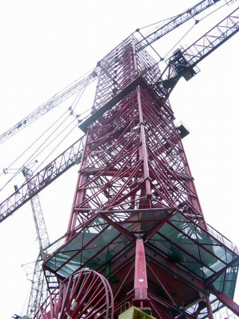

QUOTE(lina357 @ 10.08.09 - 07:59) ←
My opinion is different:
K-10000 was designed as a bottom slewing hammerhead tower crane for USSR market simply because
that kind of large cranes have been already present on the Soviet market.
I think they just needed something bigger for nuclear power plant construction.
http://tcfs.ru/modules.php?name=Forums&...topic&t=438
http://tcfs.ru/modules.php?name=Forums&...wtopic&t=56

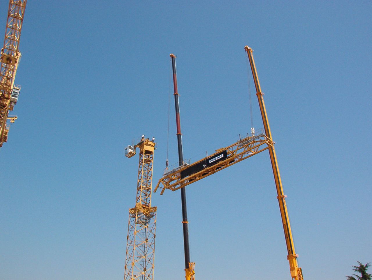

Well, now we have seen a Potain MD22500, too.
The design of a K-10000 and a MD22500 are very similar.
I have two questions:
Why bottom slewing hammerhead cranes?
Who has copied who?
QUOTE(lina357 @ 15.08.09 - 10:50) ←
Who has copied who?
1 As I already quoted Kroll officials stated that 80s K-25000 was intended to be bottom slewing because they had no technical posibility to make it top-slewing. Only an expert in physics could tell us more.
2K-10000 is older than the project for md-22500, so.....
QUOTE(djlivus @ 17.08.09 - 10:53) ←
Thanks for the informations and nice photos.
