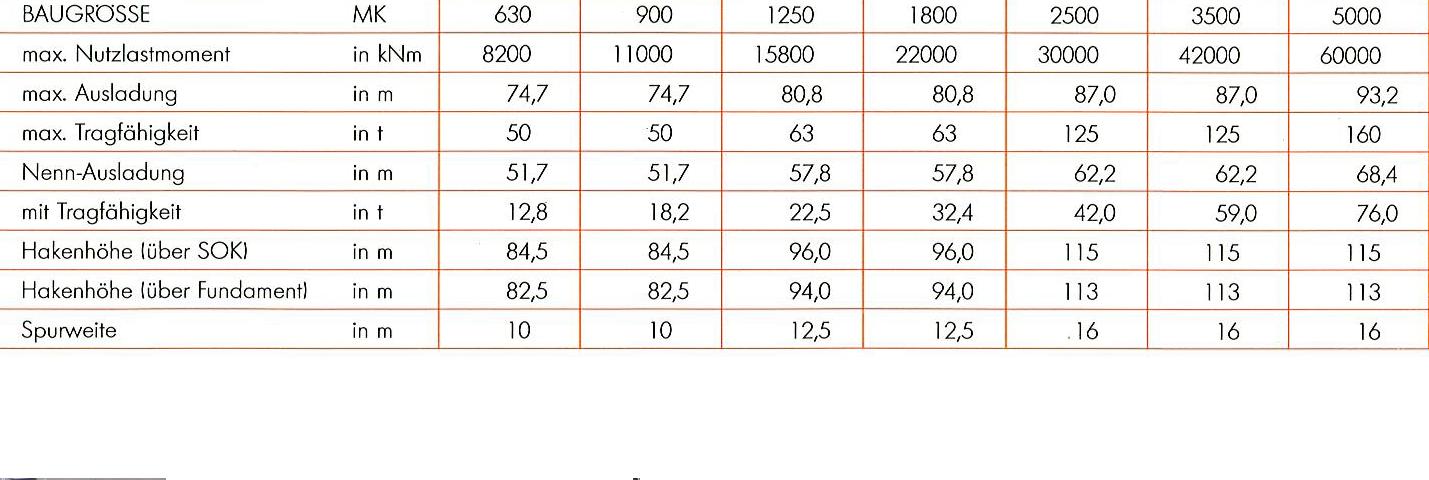

There is also kroll k-1800, from the end of 70s. They had a tower section of 5 meters and aheight under hook of at least 84 meters in the rail version. I also know a rail going kroll k-1800 with a tower height of 300 feet(91 meters). That means the height under hook is about 87 meters.
http://209.85.135.132/search?q=cache:usTOE...=clnk&gl=ro
Kroll k-1800 from 1998 for Three Gorges dam in China have a height under hook of 101 meters, and a tower section of 5.43 meters. I have the data sheet of this crane, but it is to big to be uploaded here.
