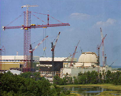

Danke für diese tollen Infos und Bilder
Nun ein paar Fragen ( ich hoffe ich Ecke mit meinem Wissendurst net schon wieder wo an)
Ich dachte immer der obere Kran ist nur zur Montage? hier ist er wohl parallel am Arbeiten war das so üblich?
Und sind das nur die "amerikanischen" Krolls mit dem Liebherr oben drauf? Oder wurde diese mal als Ersatz/ Verstärkung oben drauf gepackt?

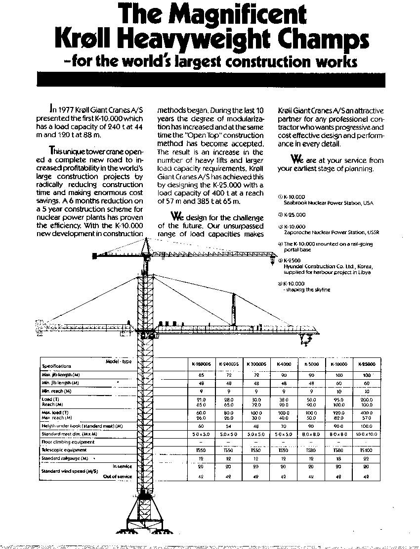

No, the upper crane is not only a montage crane. In kroll brochures is said that this upper crane is used for increasing the eficiency of the kroll k-10000. Even on the kroll site they say about kroll k-10000's top crane-quote: "independently of any heavy lift operation can work loads up to 20 t." I have even a picture with the top crane working...Actually, the upper crane is just a part of kroll k-10000, like a second jib. On many russian sites about k-10000 is presented like a special feature of k-10000 the fact that it has two jibs(booms)!!! Anyway, the upper cranes are not just kroll/liebherr cranes mounted on the top of k-10000, they are modified, adapted, so they are a part of k-10000 crane. In k-25000 project that becomes more clear, they mounted on the top just a second jib, simillar with that of k-10000!
As far as I know all russian K-10000-that is 12 or 13 of 15 have modified kroll or liebherr top cranes. Only in the case of american Kroll on the top is a small richier-this is, instead, only a montage crane.
only this richier is only a montage crane...
