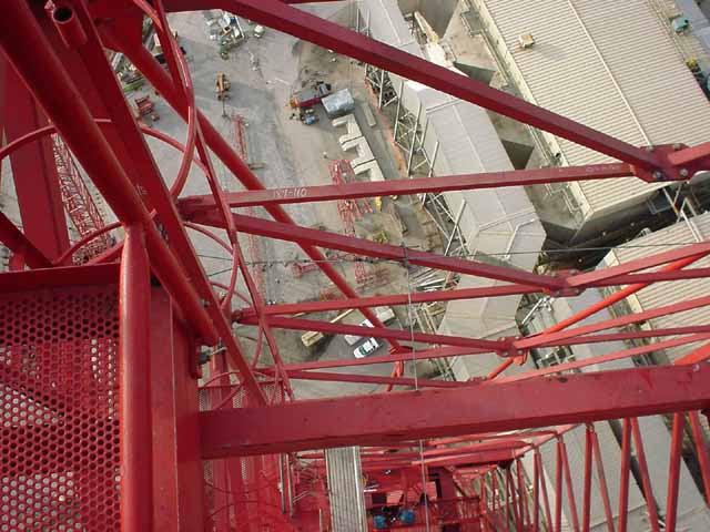

What do you think , how can these cranes be operated with no operator cab? I don't see any advantages in not having a cab. I mean operating when bad wheather...rain, wind
Maybe it is better to operate the crane via radio control from the mounting position of the beams instead of the away cabine?!

QUOTE(djlivus @ 01.04.10 - 14:01)
Compare this crane with a mobile/crawler crane with similar function and capacity.
Lifting heavy elements is performed at low lifting speed and there is usually also enough time for positioning the load.

Kroll K-1000 in USA. With Demag 4800
2010/04/post-14539-1270201980.jpg
