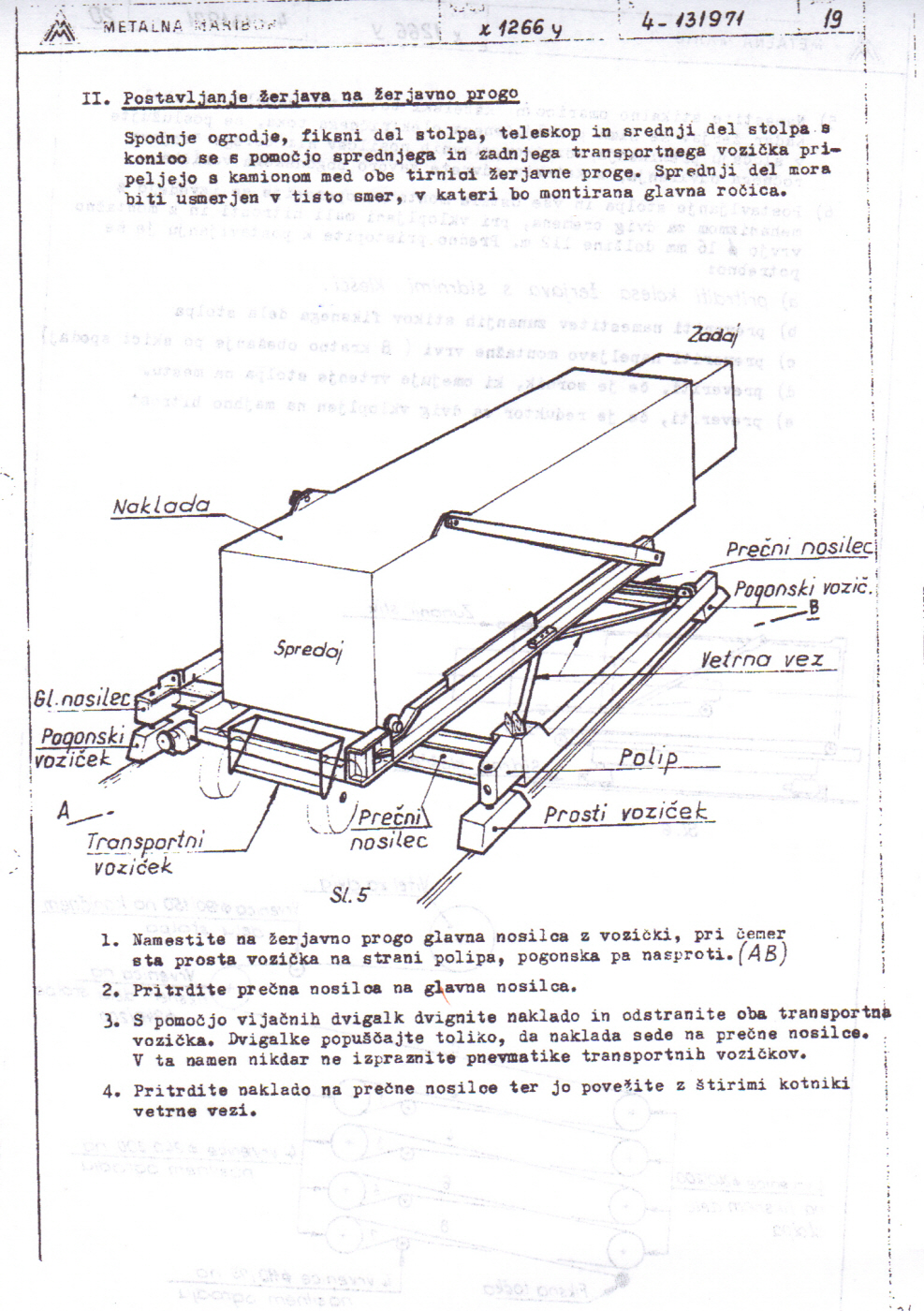

The advantage of the second generation of Weitz tower cranes was their ability to self-assemble.
In next few photos I would like to present the simplicity of assembly proceedure on X1266Y model.
After positioning of the crane between the rails cross beams are added to complete an undercarriage.
Then the assembly is lowered onto the undercarriage by screwjacks.
