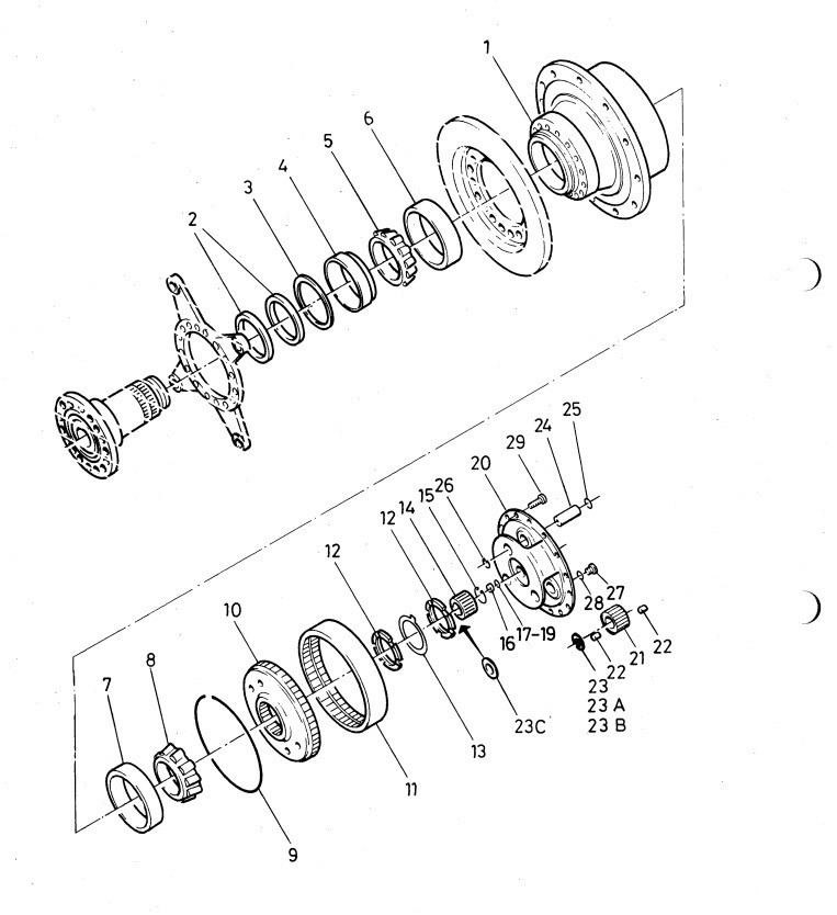

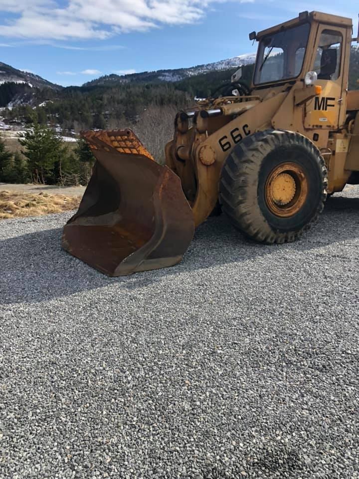

I have some issues with my Hanomag 66C wheeloader. The front axel is leaking oil quite badly, you can clearly see oil dripping down on the brake disc and inside the rim. I have checked the part number ( 3000 866 X1, NO:2 ) , and It looks like there is 2 oil seals that needs to be replaced. The problem is these parts is hard to find, and a dealer is offering these for nearly 200 $ EACH. Do anybody have the correct measurements and data of these two seals, so is it possible to find two universal seals instead?
