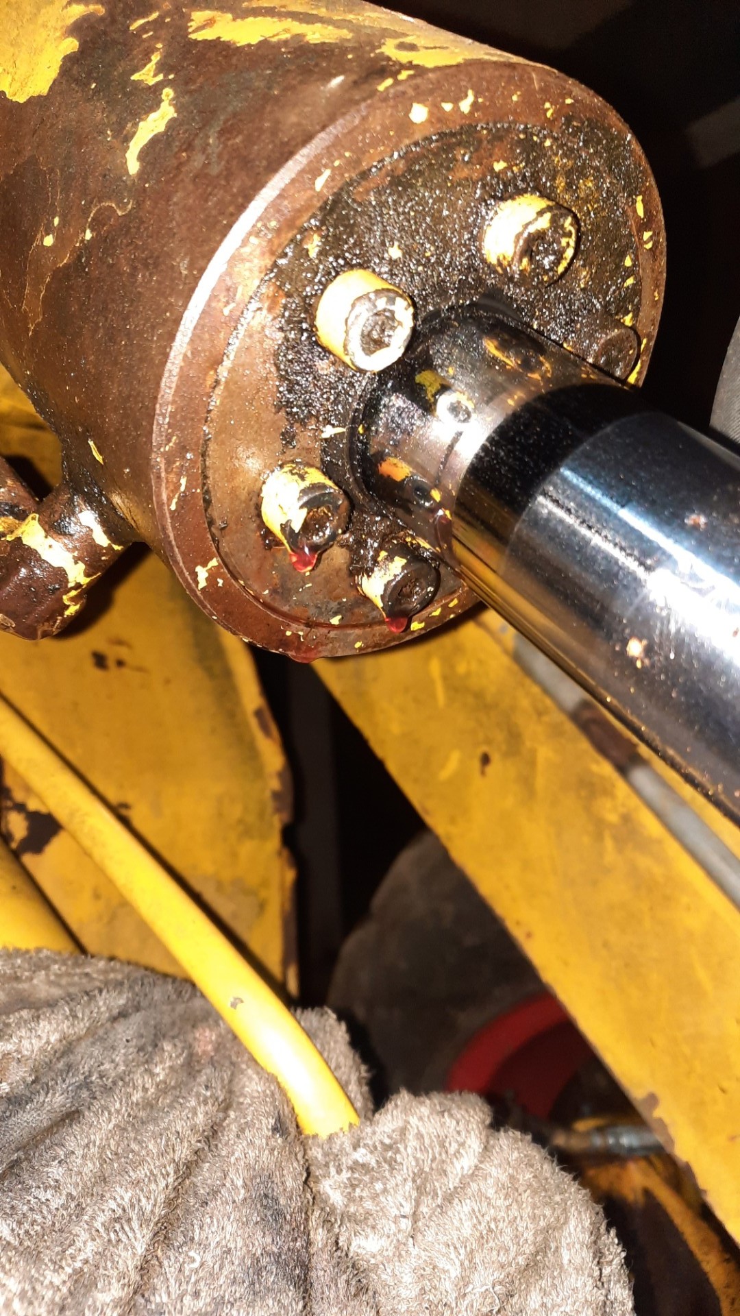

Both my lift and tilt ram are leaking ,
Has anyone changed the seals? Is it a difficult job?
Do I take the 6 bolts out then unscrew the cap??
Thank you very much Gary 20211214_180445.thumb.jpg.33e87c283d21506b9423666030df1bc9.jpg
Hallo,
mache die Schrauben und den Deckel ab, dahinter ist ein Sicherungsring, den auch rausfummeln, Stange ziehen und zerlegen, Dichtungen erneuern,
und umgekehrt zusammenbauen.

Hello again
When I remove the 6 bolts, how is the external cap removed?
By turning?
Or by pulling?
Thank you

I got it opened, two of the external cap bolt holes are threaded to m10 to remove the top cover!
