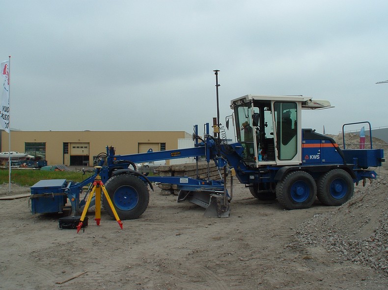

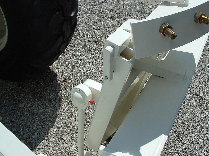

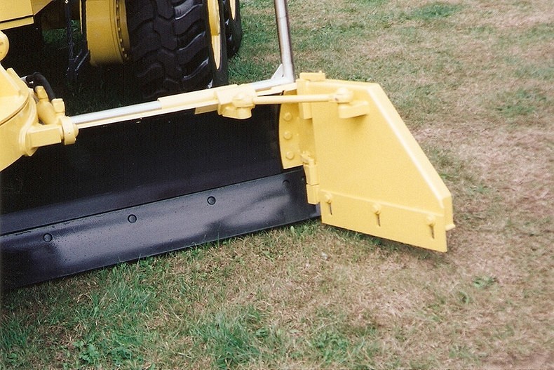

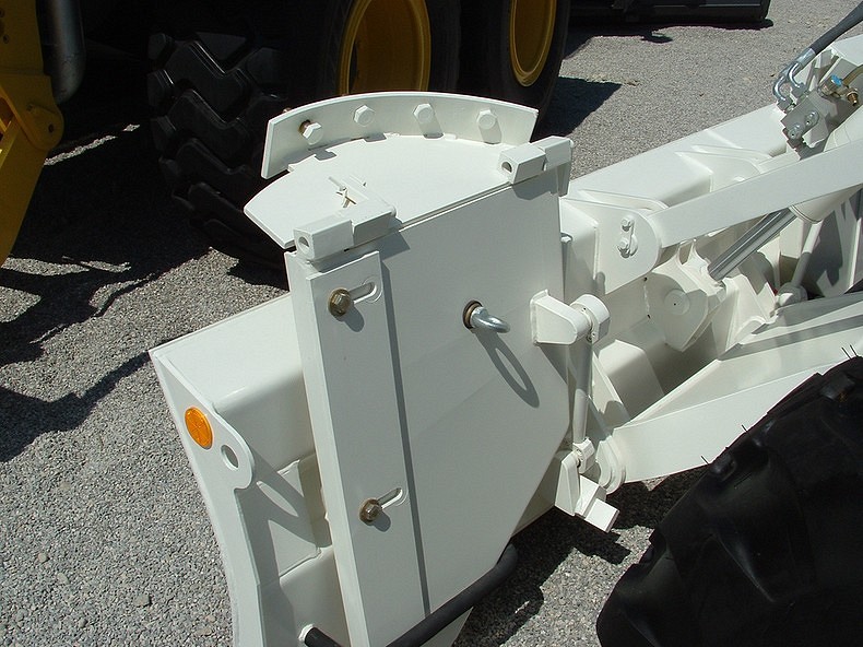

nice Grader with nice upgrades. I would like to see some details from your toolbox in the back and where you mounted it. I just started working with a grader and i am also interested how the flaps on your blade are build.
Thimo
Hell Thimo ,

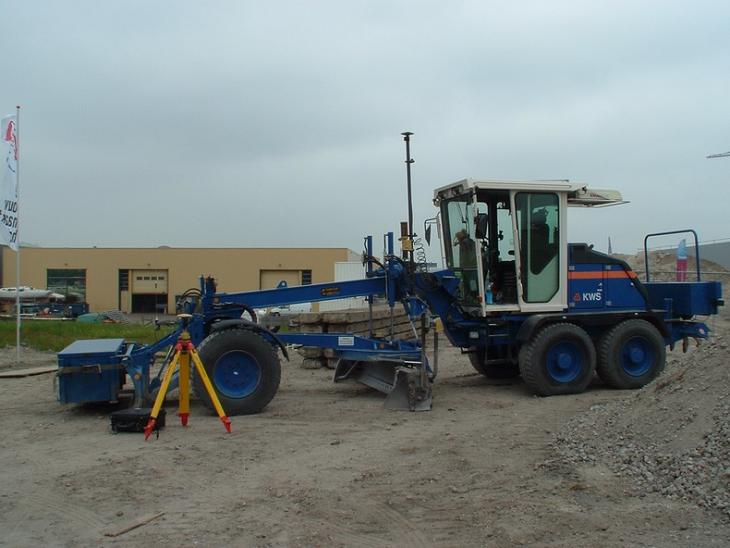

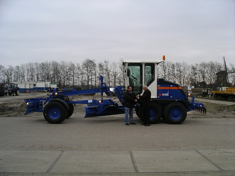

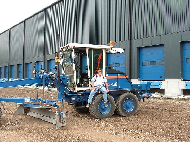

The box on the back side , i made a chassis , and welded it on the upper side of the ripper , it have two compartments , in the upper part i have a tripod for my laser , it is a high one so the laser reach out of the other machines , when you setup the laser , within 5 minutes a roller of a truck stand in the way so you have no laser therefore i setup the tripod high .In the under part i have my tools and pressure hose for my tyres . The syde plates i mouted this on the place of the side wearing strips . In my left mudguard , i mounted a square tube for instal my laser mast for when i dont need it and for transportations . I made later a bigger box , and integrated the back lichts on the box . . I made a plate with a sqaire tube for the laser mast on the sideplates so you dont have the remove the mast when you most use the the sonic tracers mounted on the L pipe.I post some photo,s of the laser mast and the sideplates and how they stored them , and sideplates from HBM I hope you have someting on this story .
