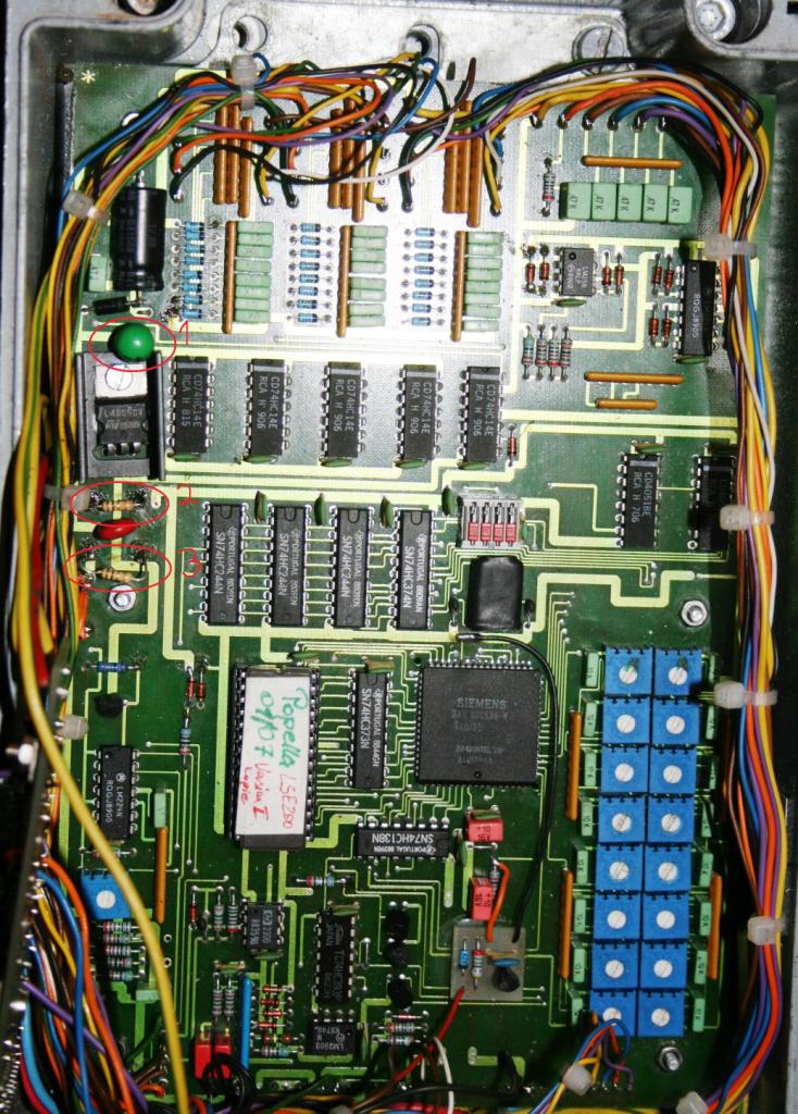

I have a problem with my Steuerungen für LSE-Bagger. does anyone have a picture og this printboard? if you have a picture i would really need it. i just need to see what is different from mine. i saw one picture here: http://www.popella-baumaschinen.de/service.html , but was to small to se the components.
thank you.
my adress is jossy73@hotmail.com if you have a picture. and again thanx if someone can help me.
Does anyone know what shall be in these 3 rings?
Number 1 is broken:-( and we dont know what is default from factory in nr 2 and 3
1:?
2:?
3:?
Hope for some answers :-)
Thanx

My problem is that i dont think nr 2 and nr 3 is what should be there, i think the owner before me put in these because he didnt get the maschine to work. the woltage is wrong and then it moves when you start.
